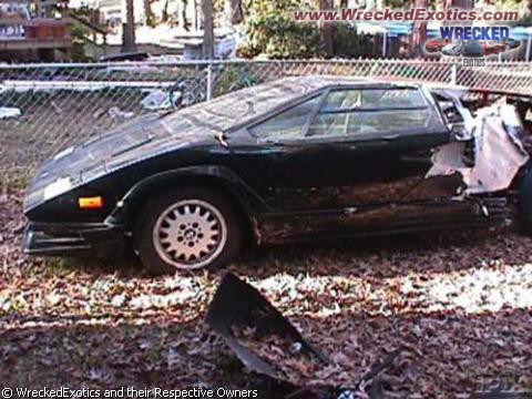

dachte immer,OZ und Lamborghini sei auf das Felgenhorn geprägt,
lasse mich aber auch gerne eines besseren belehren.
wer kann was über "diese" Felgen sagen
These are the ULTRA rare Countach S2 wheels. When the Countach LP400S was introduced, the first 100 or so cars had the Bravo Style Magnesium wheels, beginning with #1121102 Campagnolo was asked to simplify the design and they answered with the Magnesium S2 wheels you see here. When the LP5000 was introduced, Lamborghini changed to OZ aluminum wheels (slightly heavier) with the same design as the S2 wheels. Less than 80 of these wheel sets ever produced for the factory.
This set came on my Countach #1121254, but I prefer the Bravo style wheels and once I had found a set of them (nearly impossible), decided to sell the original wheels. They are in good condition with minimal chips, excellent centre caps/clips and Yokohama tires in good condition- no cracks and 80% tread on the rears, 90% on the fronts.
Das sind eventuell Technomagnesia, bei denen ist nichts eingeprägt, auch bei den Campagnolo ist der Schriftzug drin.
yepp,
sind technomagnisia...
besten dank für die schnelle antwort
Die gleiche liegt bei mir zuhause unter dem Schreibtisch...
