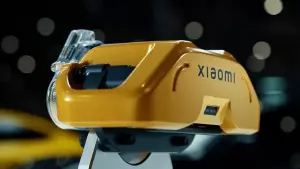

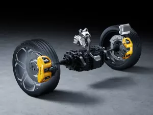

Xiaomi bzw. die Chinesen versuchen hier aber wohl die Bremse komplett ohne Hydraulik (full-dry) zu realisieren. Das wäre schon ein großer Schritt weiter https://autonews.gasgoo.com/new_energy/70035116.html
Zitat
48V Brake-by-Wire System
Xiaomi Auto has introduced the world's first 48V full-dry brake-by-wire system, upgrading the low-voltage system from 12V to 48V. This reduces low-voltage power losses by 75%, resulting in faster response times and improved safety. The higher voltage provides greater bandwidth, meeting the rising demand for high-power components in intelligent vehicles.
Xiaomi achieved two major breakthroughs with its 48V brake-by-wire system. First, it features “full-dry” electric calipers, where the motor-driven piston clamps the brake disc, enabling precise electronic control. Second, it debuts a dual-piston electronic brake caliper design, further enhancing braking performance.

Das ist ja auch keine Raketenwissenschaft, und die Bilder zeigen ja nix außer Bremssattel mit Servomotor.
